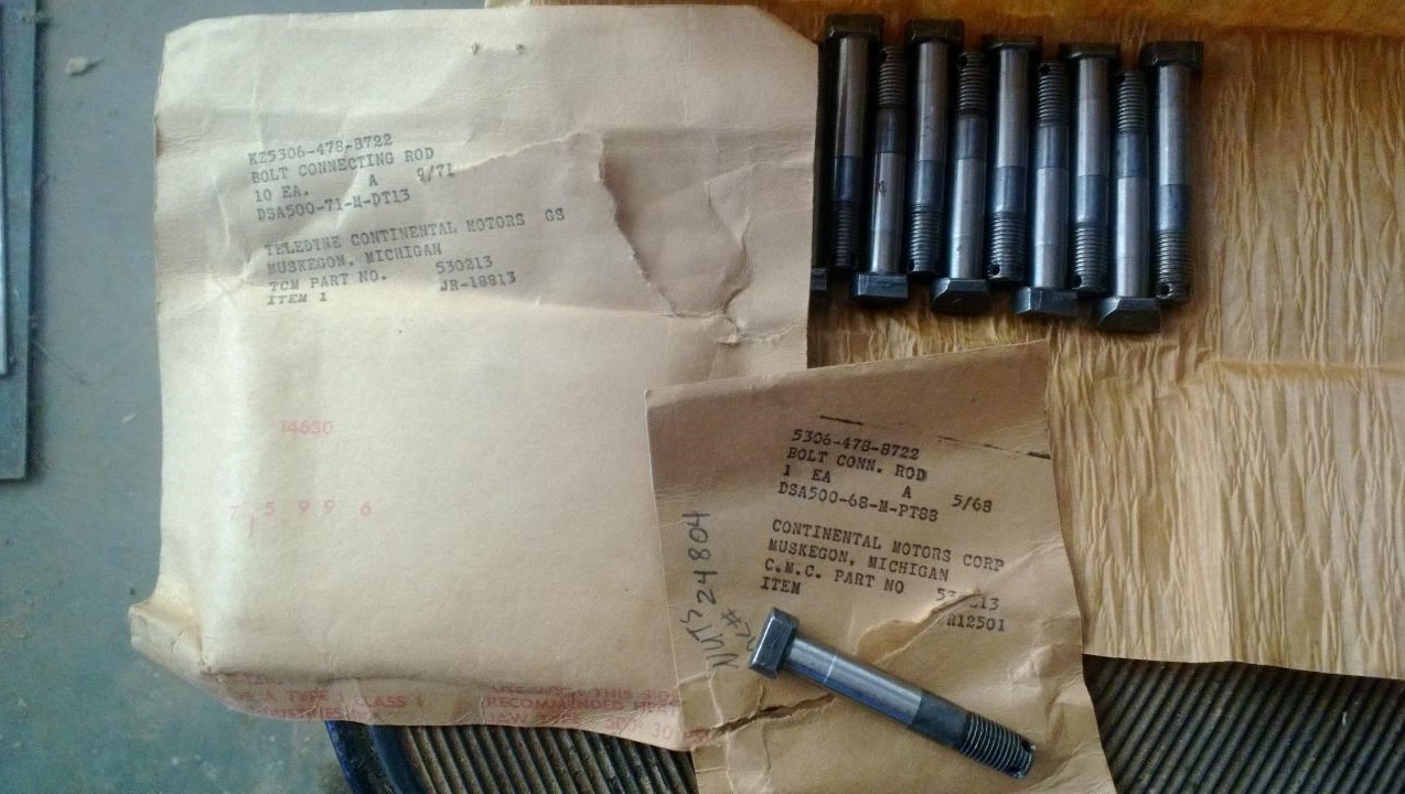

Sure. Thanks!GeneOn Jul 21, 2014, at 1:03 PM, "tkreiner" wrote:> > If you missed the Conn Rod Bolts last year, and want the security of knowingthe ones you're building that $4000. engine with are going to hold together, youmight be interested. I'm bringing more to Brodhead this week. > > These are Sealed packages of 10 NOS (New Old Stock) Conn Rod Bolts, ContinentalP/N 530213. > > Will fit ALL A Series, C Series, O-200, O-300, and several more small Continentalengines.> > Shoot me an email and I'll make sure I bring enough. > > These are over $17.70 EACH from ACS,, but the 10 pce bag is only $100. to PietBuilders. Savings to you $41.+ and you get 2 extra bolts.> > --------> Tom Kreiner> > > > > Read this topic online here:> > http://forums.matronics.com/viewtopic.p ... 071#427071> > > > > Attachments: > > http://forums.matronics.com//files/conn ... ts_134.jpg> > > > > > > > ________________________________________________________________________________Subject: Pietenpol-List: Re: weight and balance
