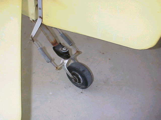

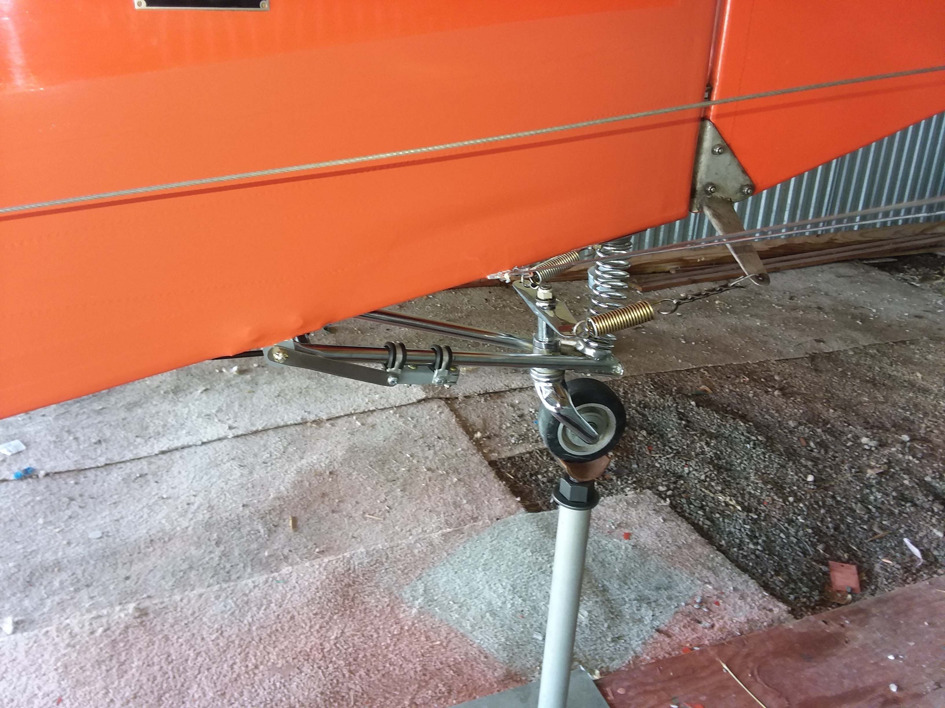

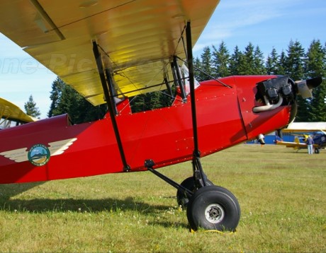

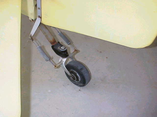

The usual way to differentiate a Grega from a Pietenpol is to look at the main landing gear attach points to the fuselage. On the Grega, the forward mounting point is the same as the Piet but the aft is moved forward and does not coincide with the mounting point for the aft lift strut. However, they aren't all set up that way. Another difference is the mounting for the cabane struts. On the Piet, the cabanes are mounted such that the wing can be pivoted forward and aft, while the Grega mounts them such that that is not possible. On most Gregas, the tailwheel is steered via a pair of arms off the lower sides of the rudder rather than by its own set of cables going aft from the rudder bar.
Pix of the Grega GN-1 landing gear mount and tailwheel steering setup attached.
Posts: 370
Re: Luscombe wing
Lots of variations in Piet construction. N34KP (built from Pietenpol plans, short, wood fuselage) has tail wheel steering working off the rudder, with a wooden rudder structure.
