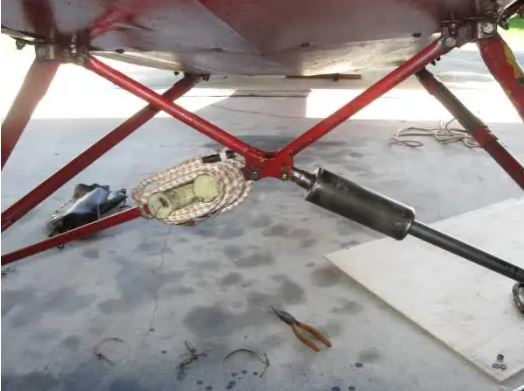

John; if you're thinking of the Cub-style gear, I can highly recommend the "canned spring" die spring gear setup as done by William Wynne. My spring struts are similar but are not enclosed as the WW style are. See photo below, side-by-side comparison of the traditional Bungee shock arrangement with the much cleaner and more robust enclosed die spring setup on Bob Lester's Piet as the work of converting from bungees was underway.

Thanks...and I've seen WW with Earl's plane also. That's the way I'm going to do it....once I figure it out:)
