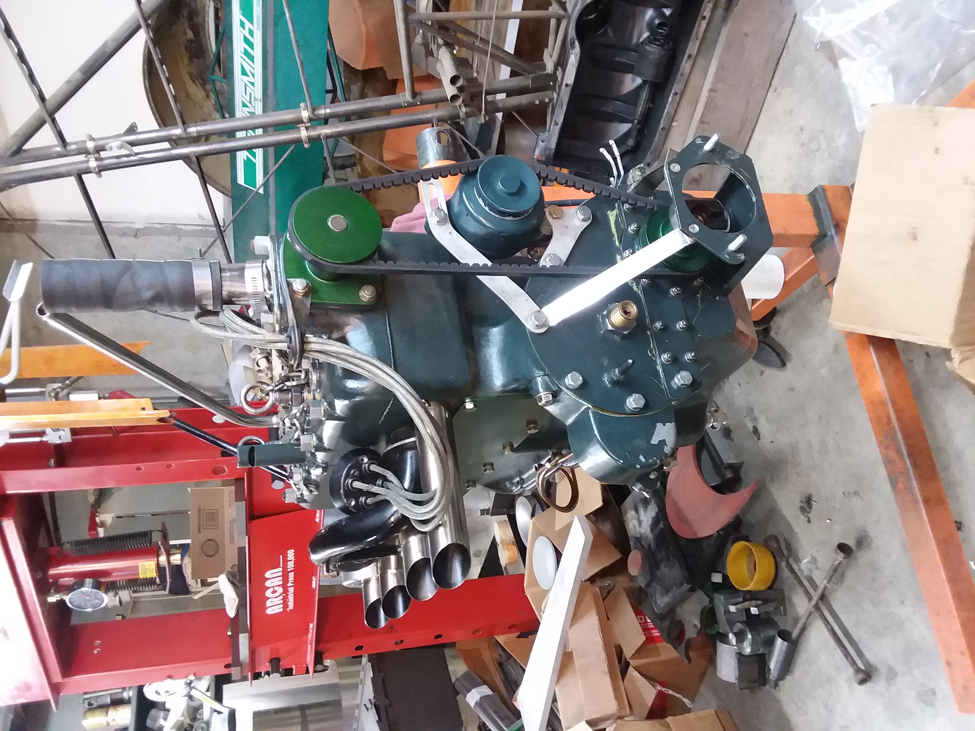

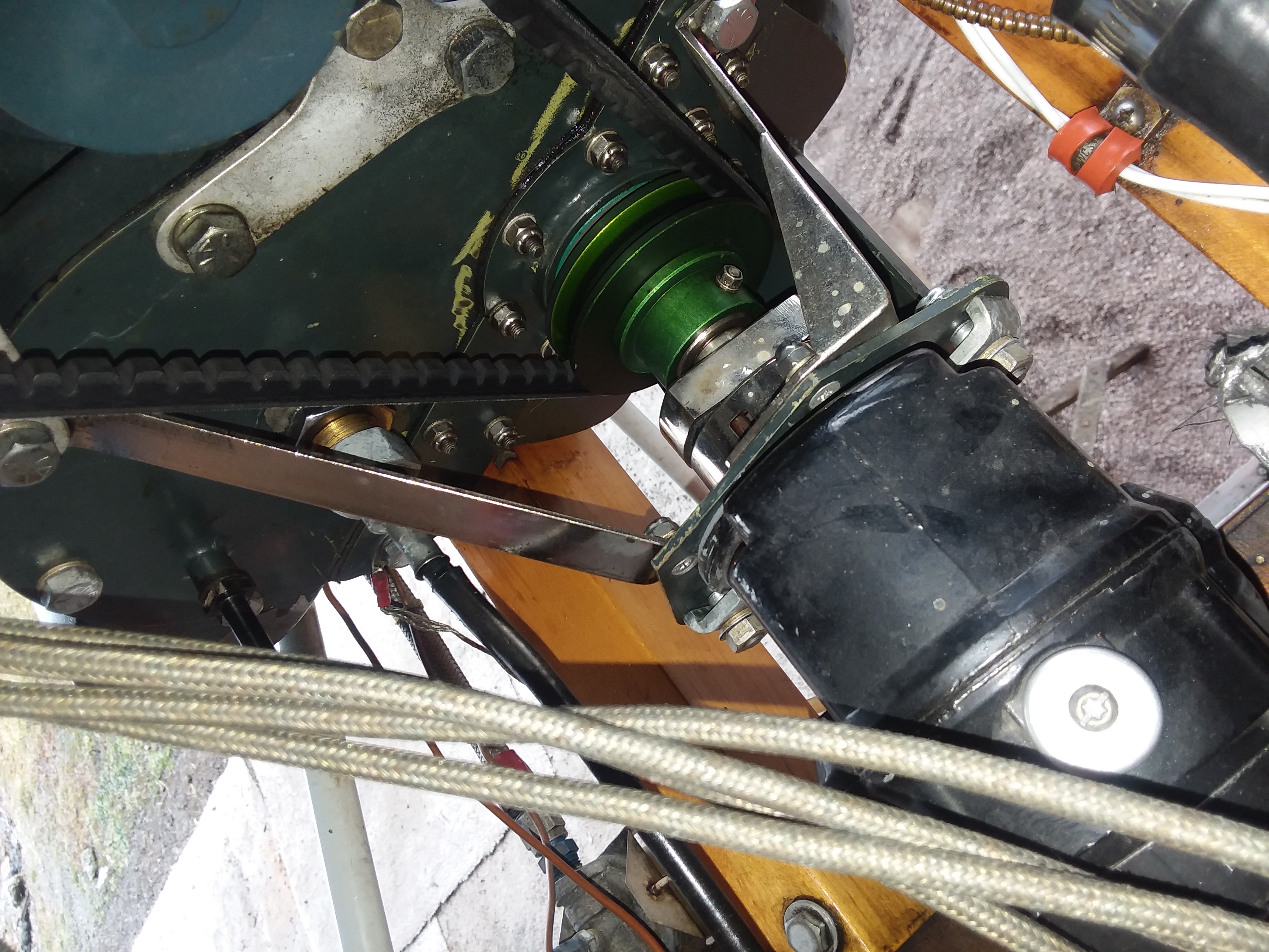

Most people fly with high compression aluminum heads. The Piet I fly has a model B cam in it. Previously it had a touring cam. I have a single mag drive off the crankshaft at the moment. There are several with duel mags, driving off the crank and the governor drive on the side of the engine (if you have a governor drive). Dan Helspurs Piet drives one mag off the crank and one through the distributor hole, top of the engine. As far as I know there isn't anyone supplying a turnkey engine for the Piet. Lots of AER parts flying around. I'm not aware of a Burtz block as yet flying. I like the idea of 5 mains and the better crank seal, but they are heavy. Still, Piets have flown with flat head Ford v8's, so I'm sure it could be done.

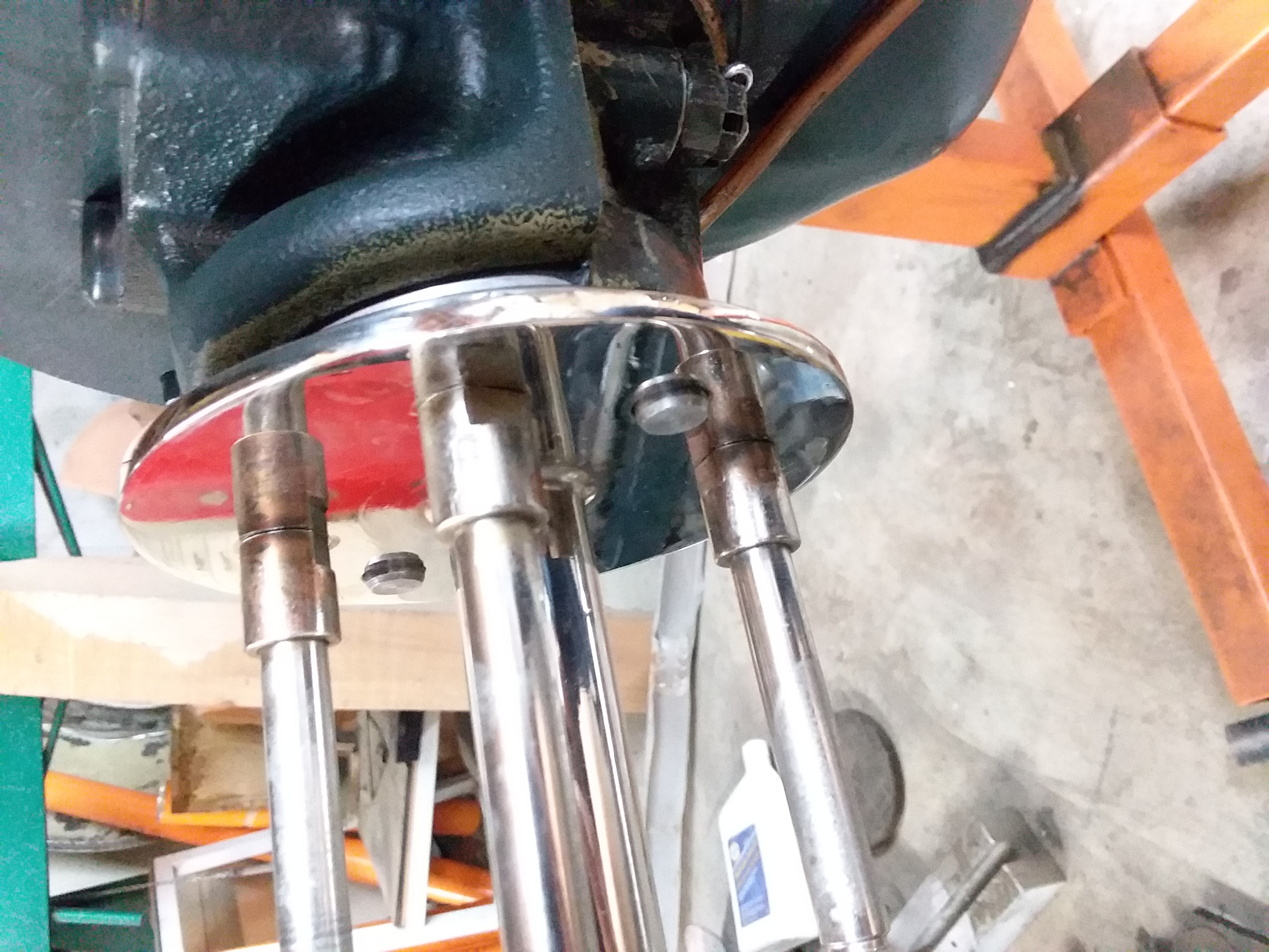

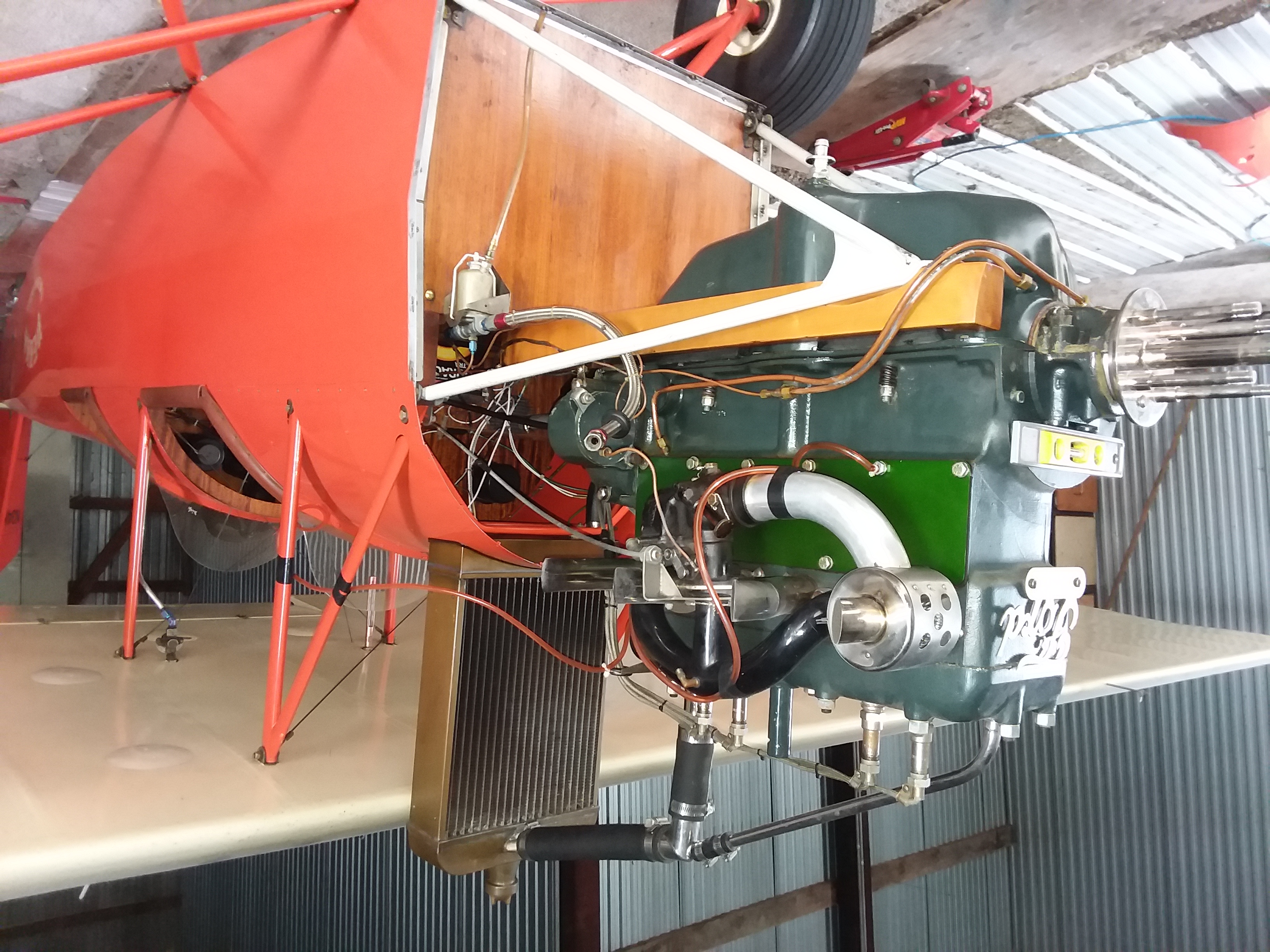

Ken Perkins built this Piet. He made the prop hub per the plans. The prop is an Ole Fahlin prop Ken ordered in the early 1980's. Ken made a few 6 bolt SAE 1 hubs that would fit the Model A crank, I think Dan Helspur's Piet might have one, but I'm not sure. I don't have one. I don't know if anyone is making them. This Piet is flying with a Zenith carb, from a model A. Currently it has a Slick 4301 magneto installed.
