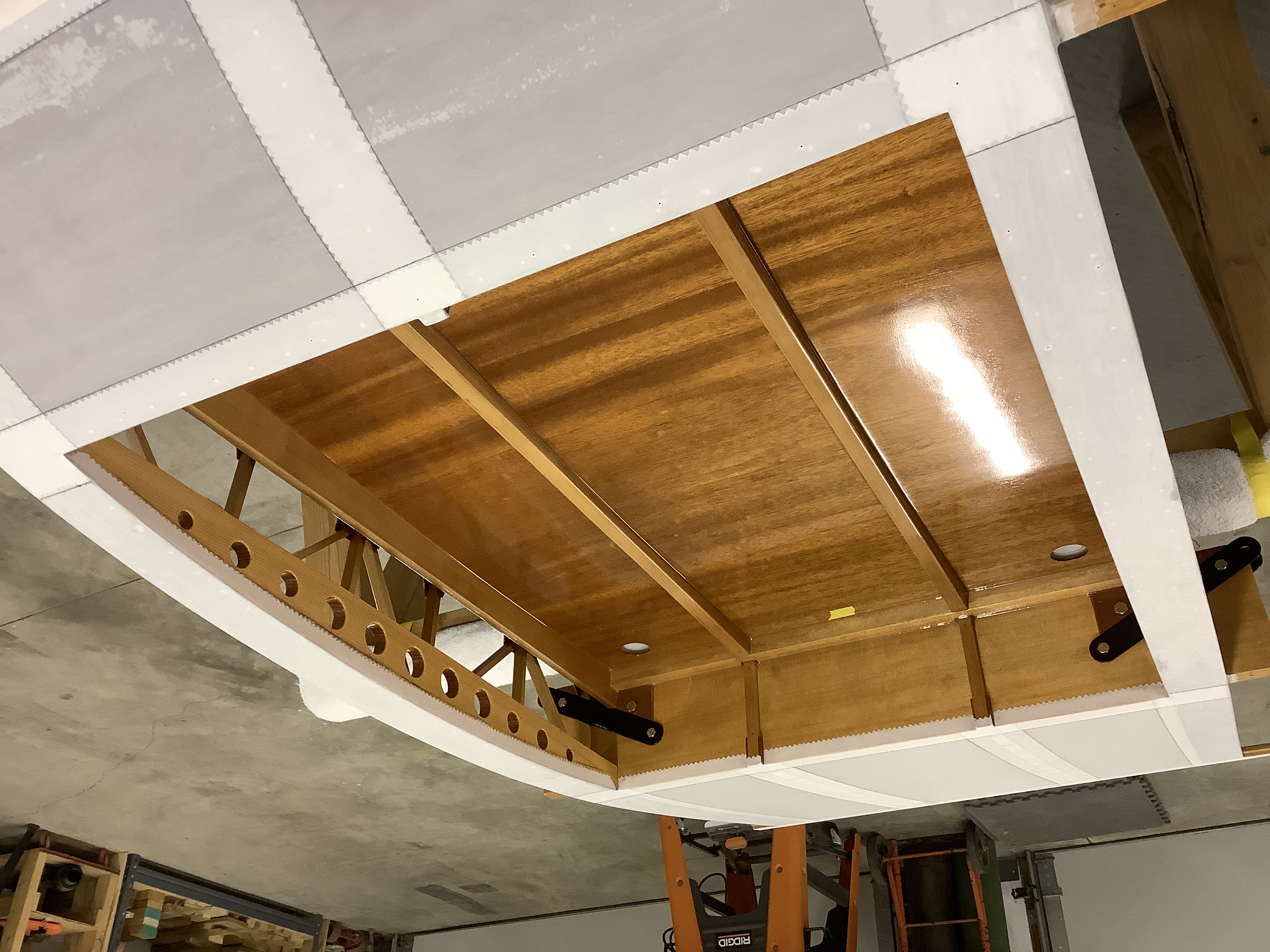

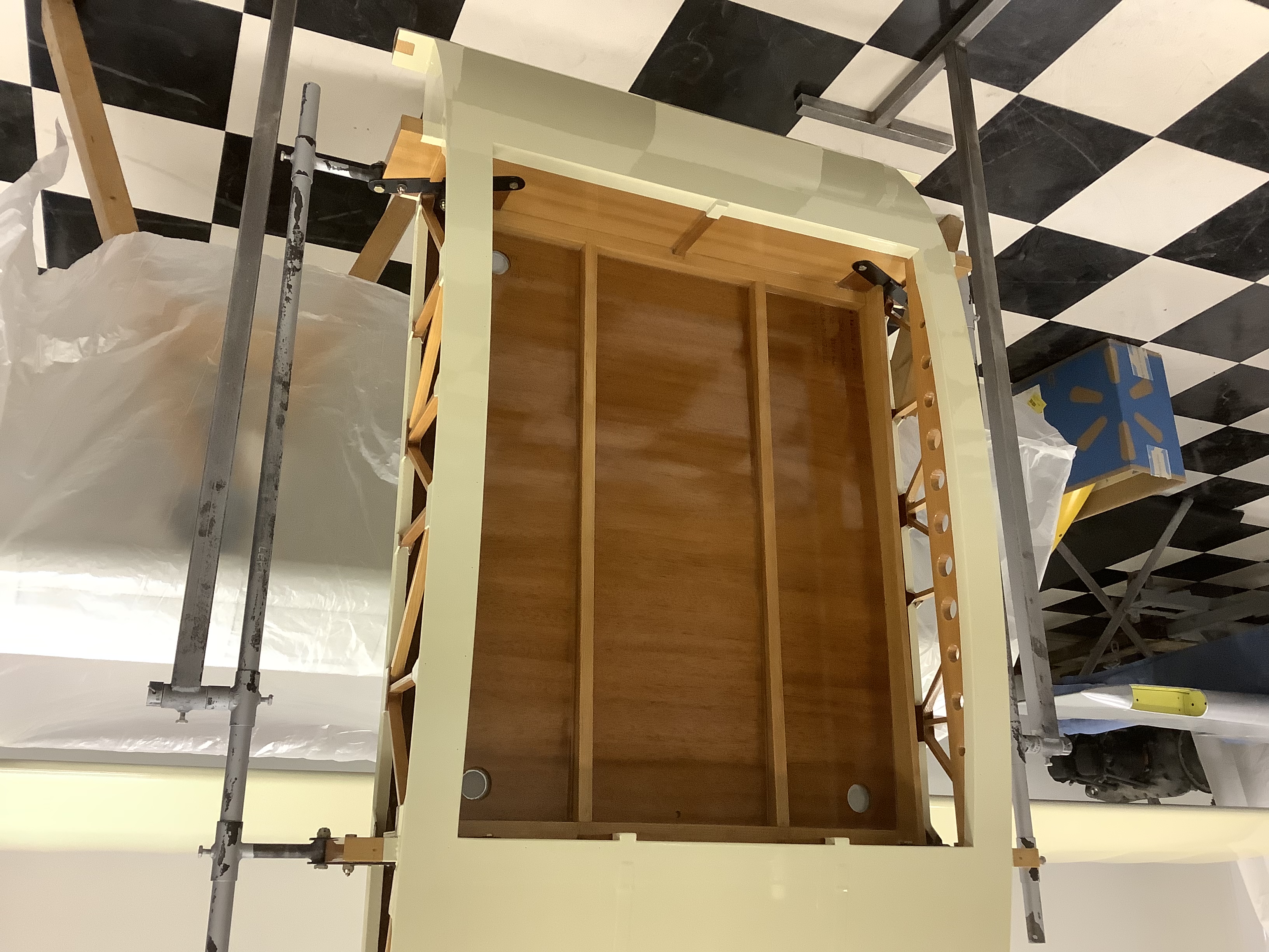

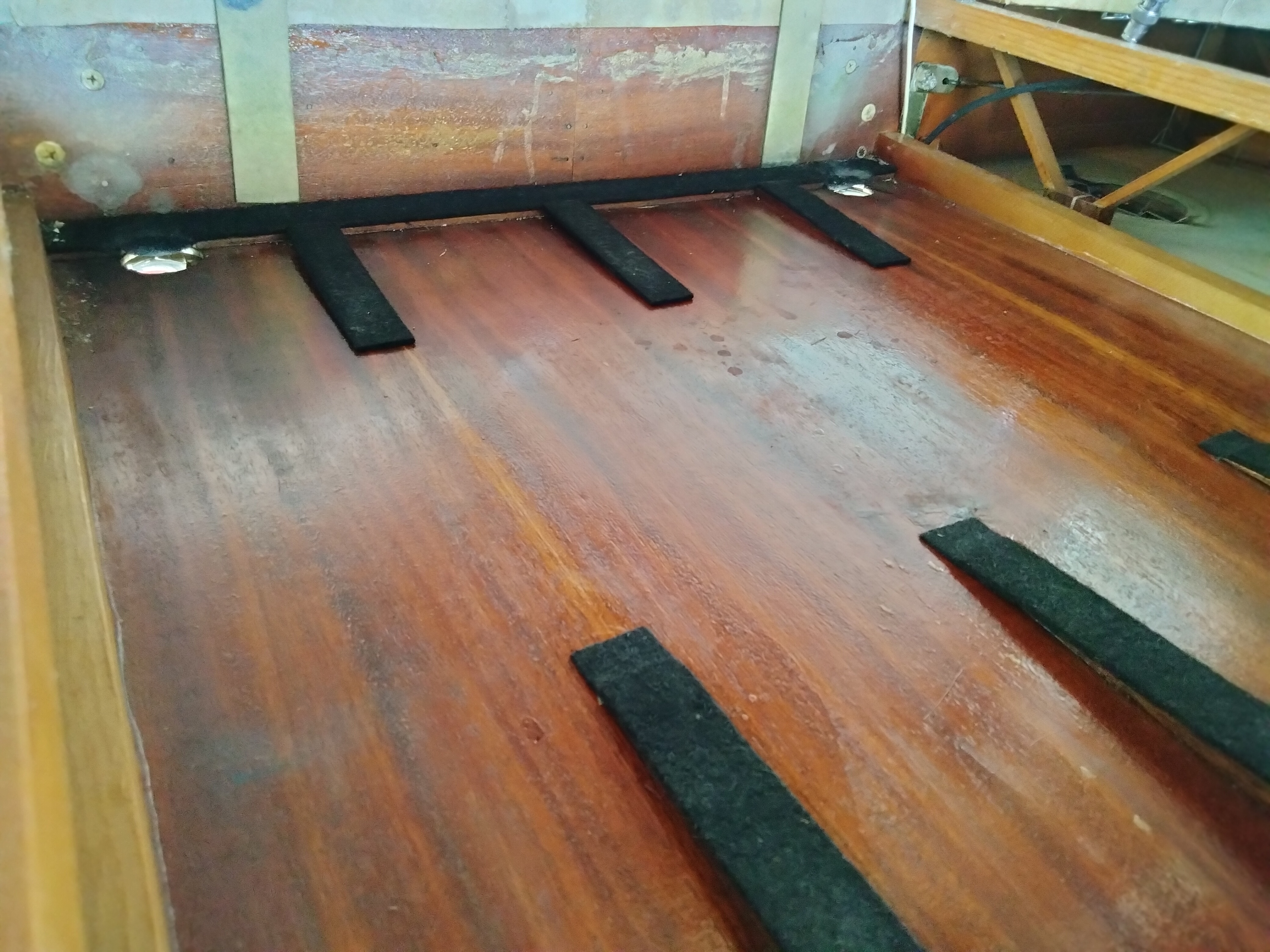

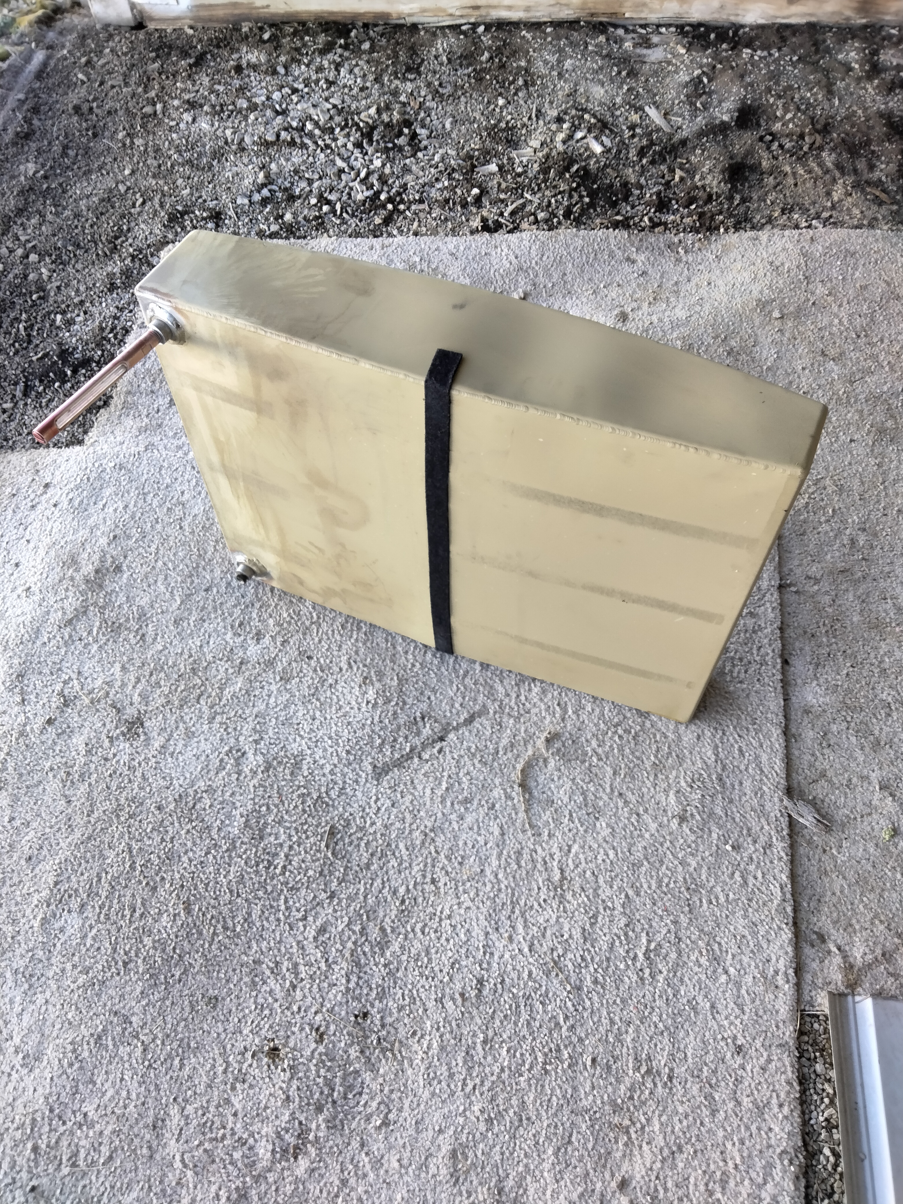

Re: Center section questions
Made supports for front and rear attached to spars and floor. Center supports added. Fuel tank sits on those supports. Fuel tank made to largest size possible, and is a tight press fit with felt around edges. Top cover over top of tank holds tank down. No need for any straps or drilling holes in spars for straps.

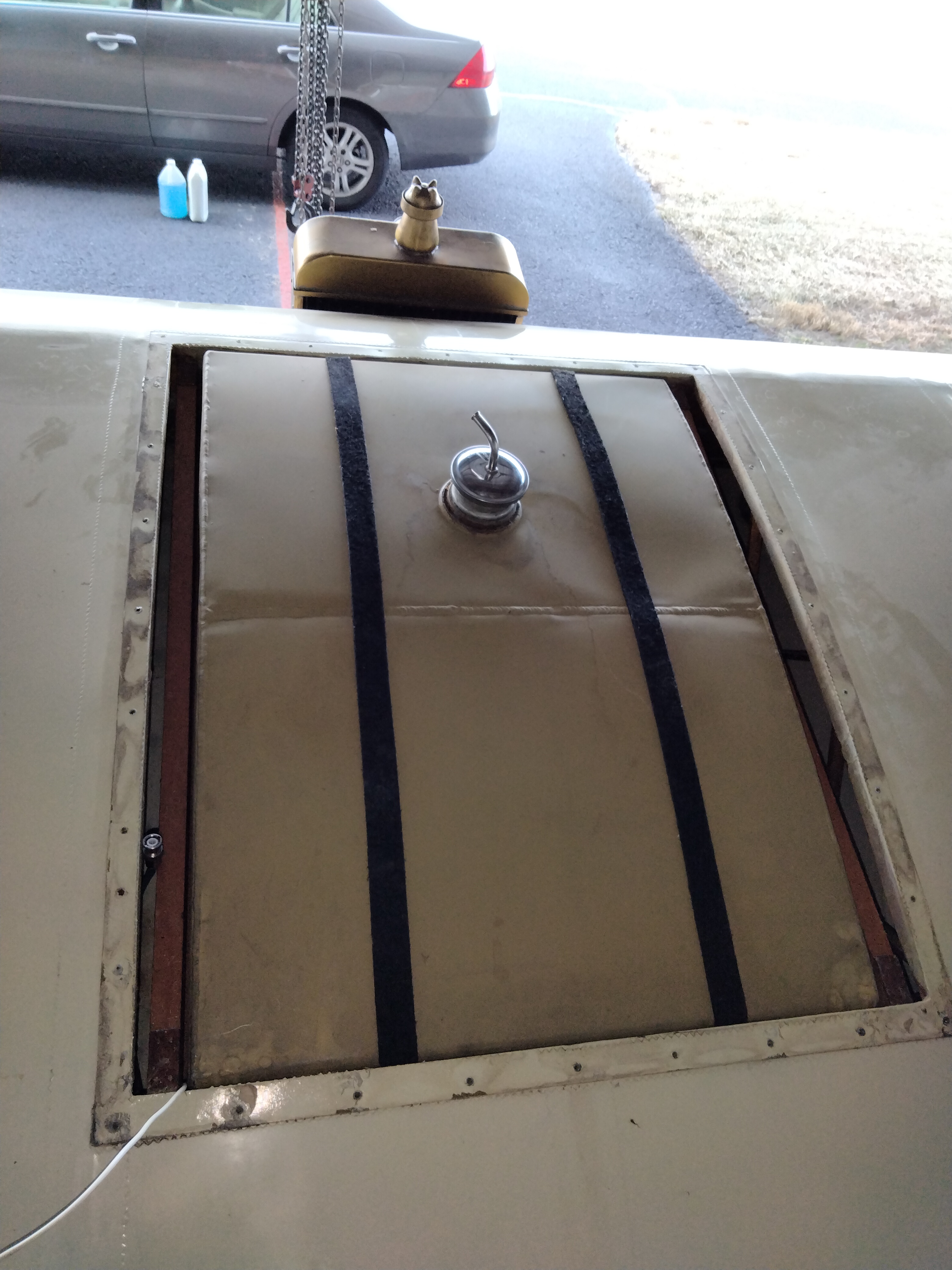

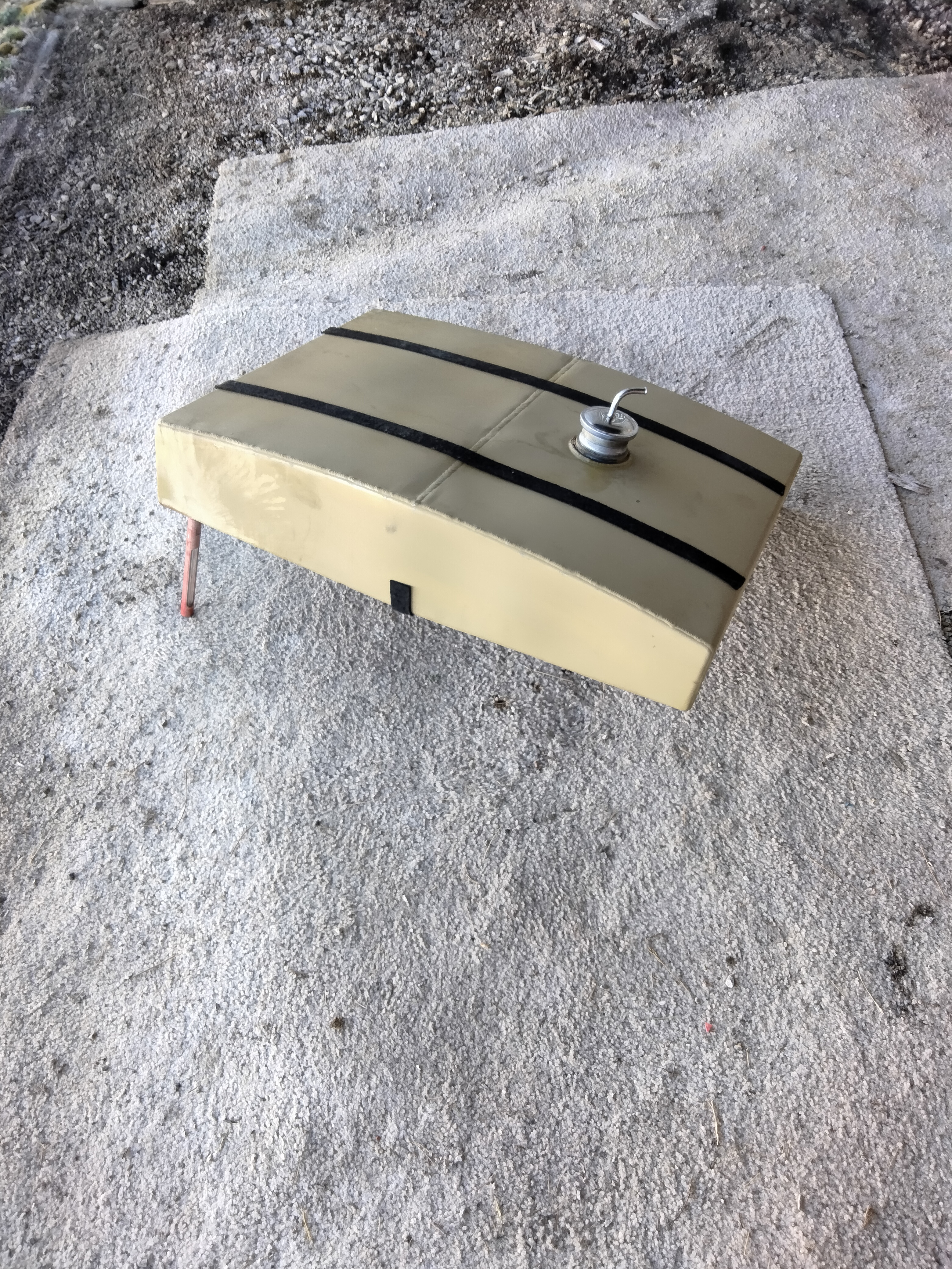

With cover on.

Thank you Rob for those photos. Nice looking work there!
- Posts: 345
Rob. Yours if very close to 34KP's setup (flying since 2000). The wedges were added in 34KP's case due to oil canning being heard when fuel was put in the Tank. Ours is also a very tight fit with the tank cover holding the tank in. I like that you off-set your filler to one side. Ours is in the middle and a pain to see into when fueling! Any idea of your capacity? Ours holds 13.5 gallons, just over 12 useable. Oh, it's a single fuel outlet in the corner, which doesn't thrill me.

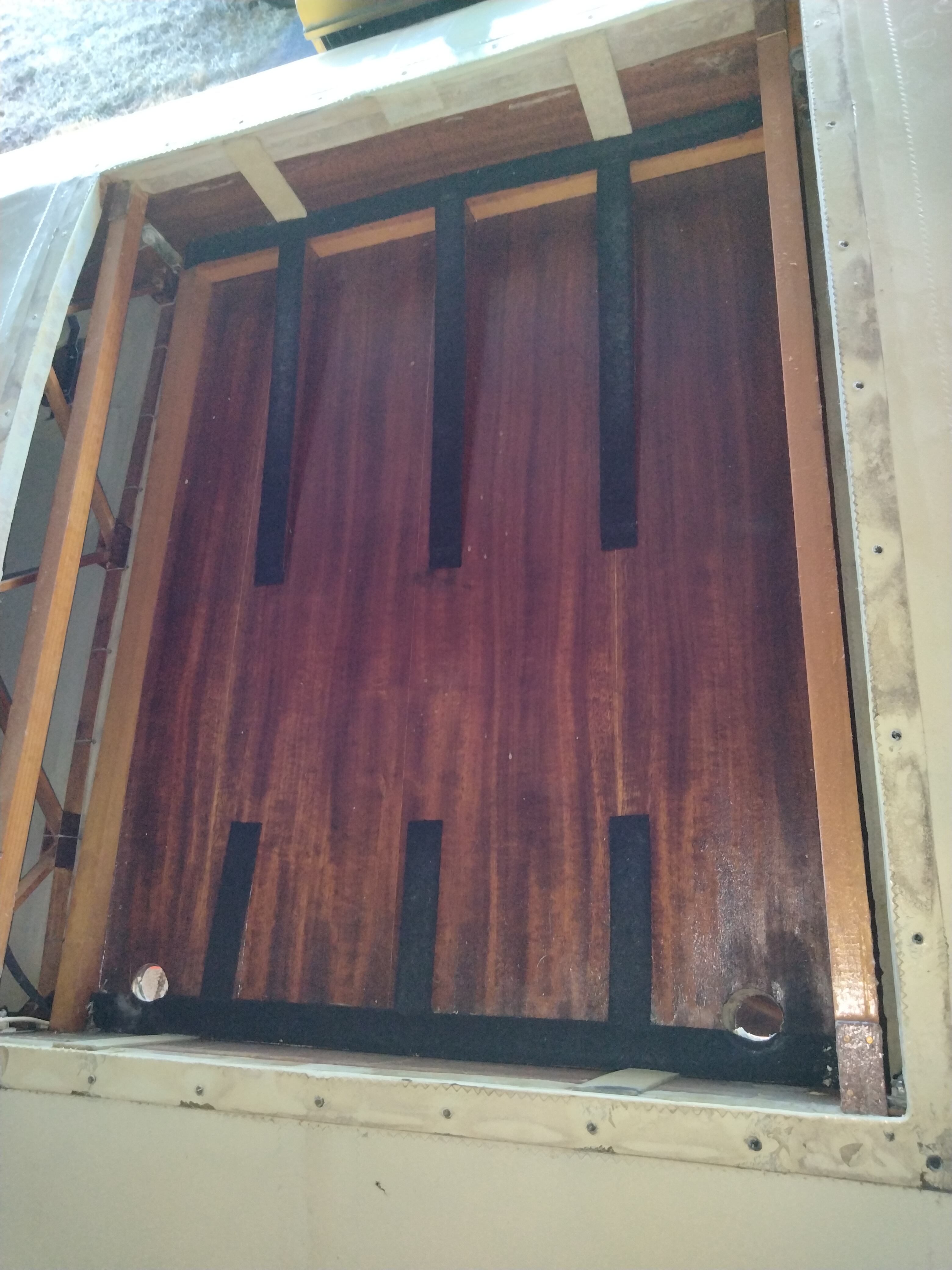

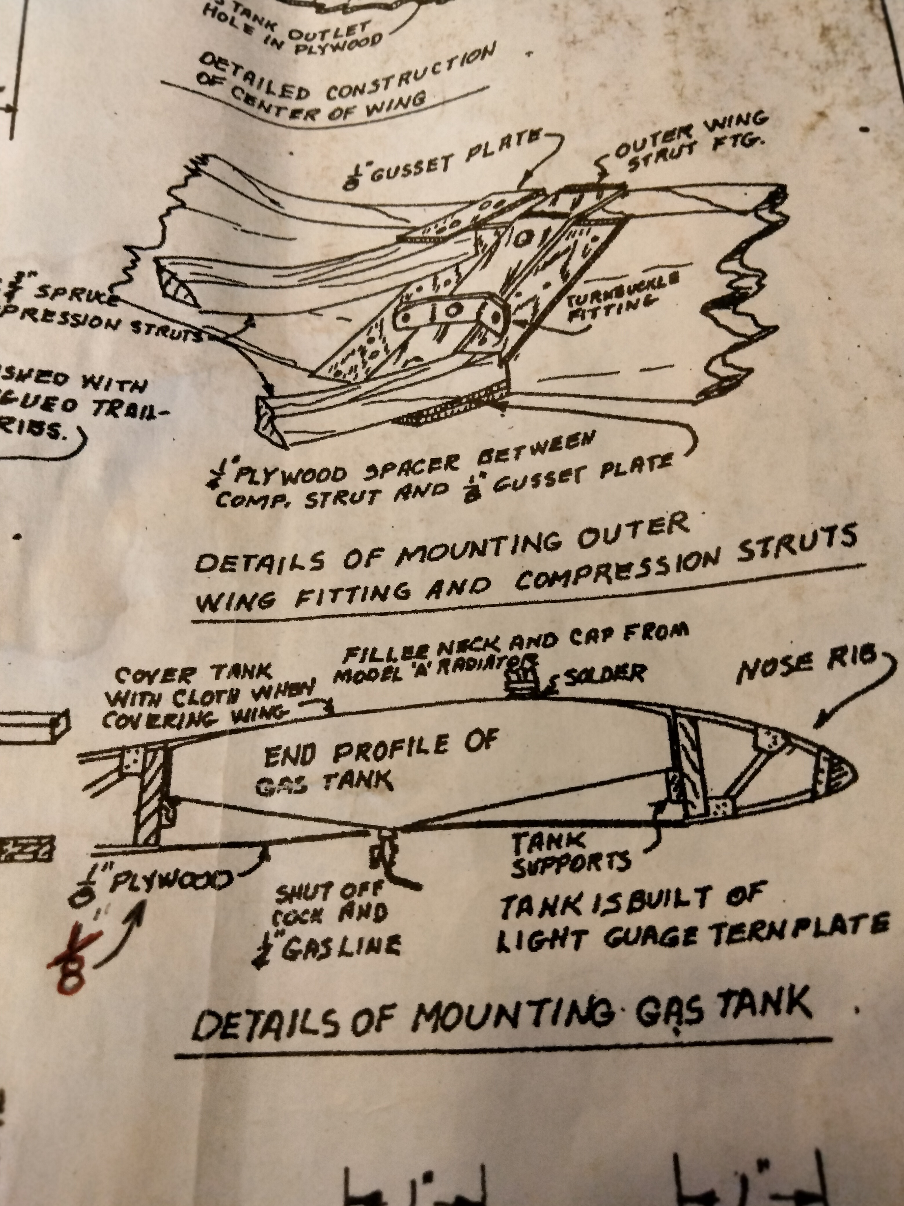

This is what I was referring to earlier as to tank mounts. Ken didn't do this and as you can tell from my prior pictures he built the tank to fill the maximum area between the spars for maximum fuel.

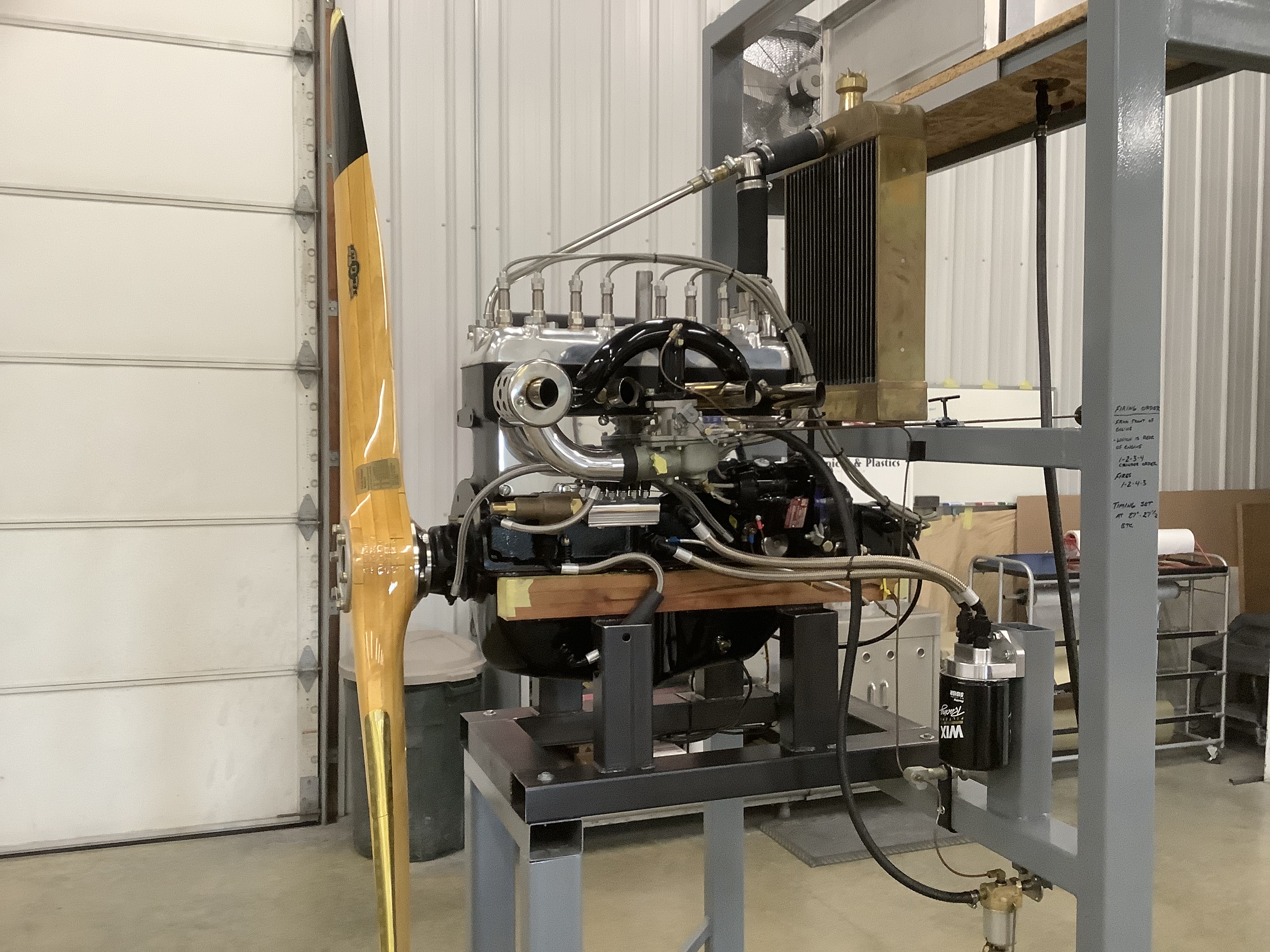

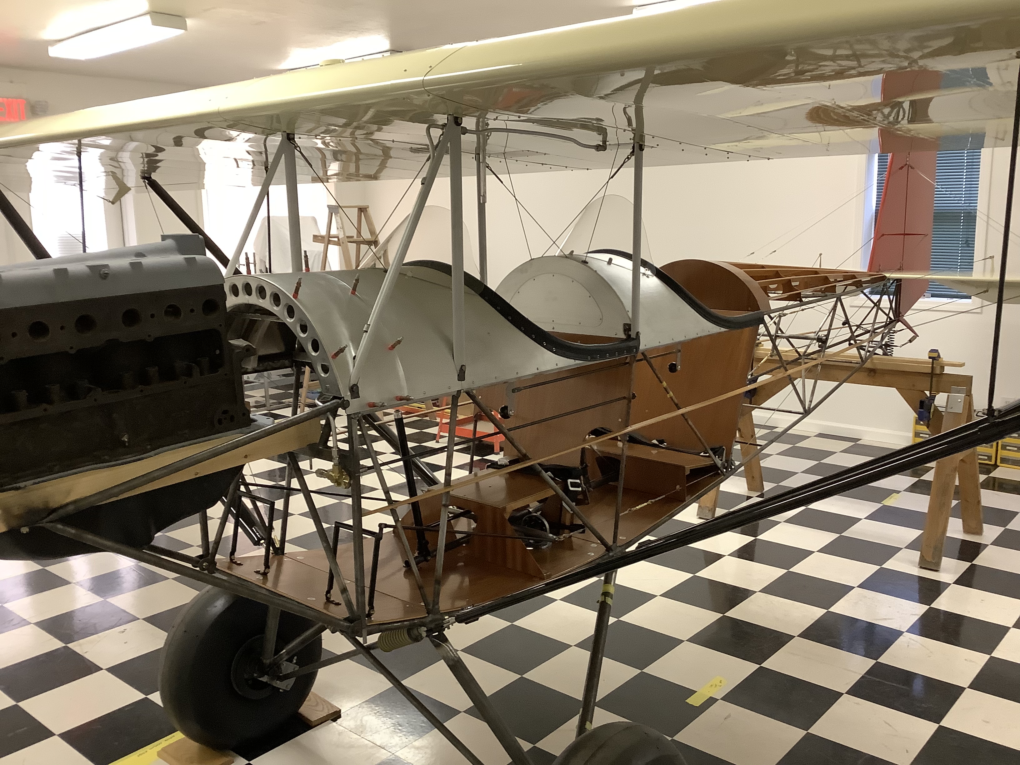

Rob. I see you're building with steel tube, which would be my preference. What engine do you plan on using?
It’s the steel fuselage per original drawings. Model A Ford.

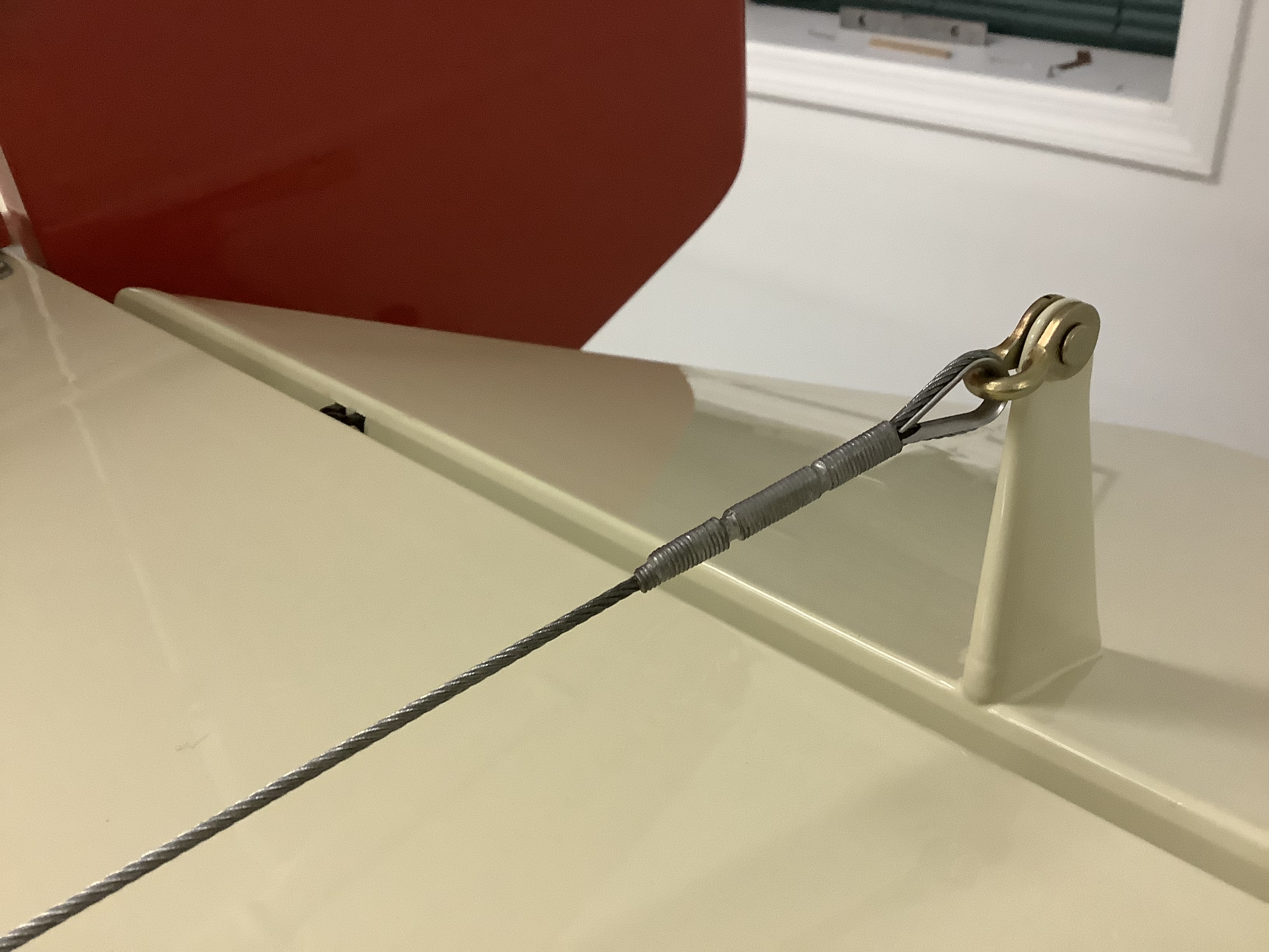

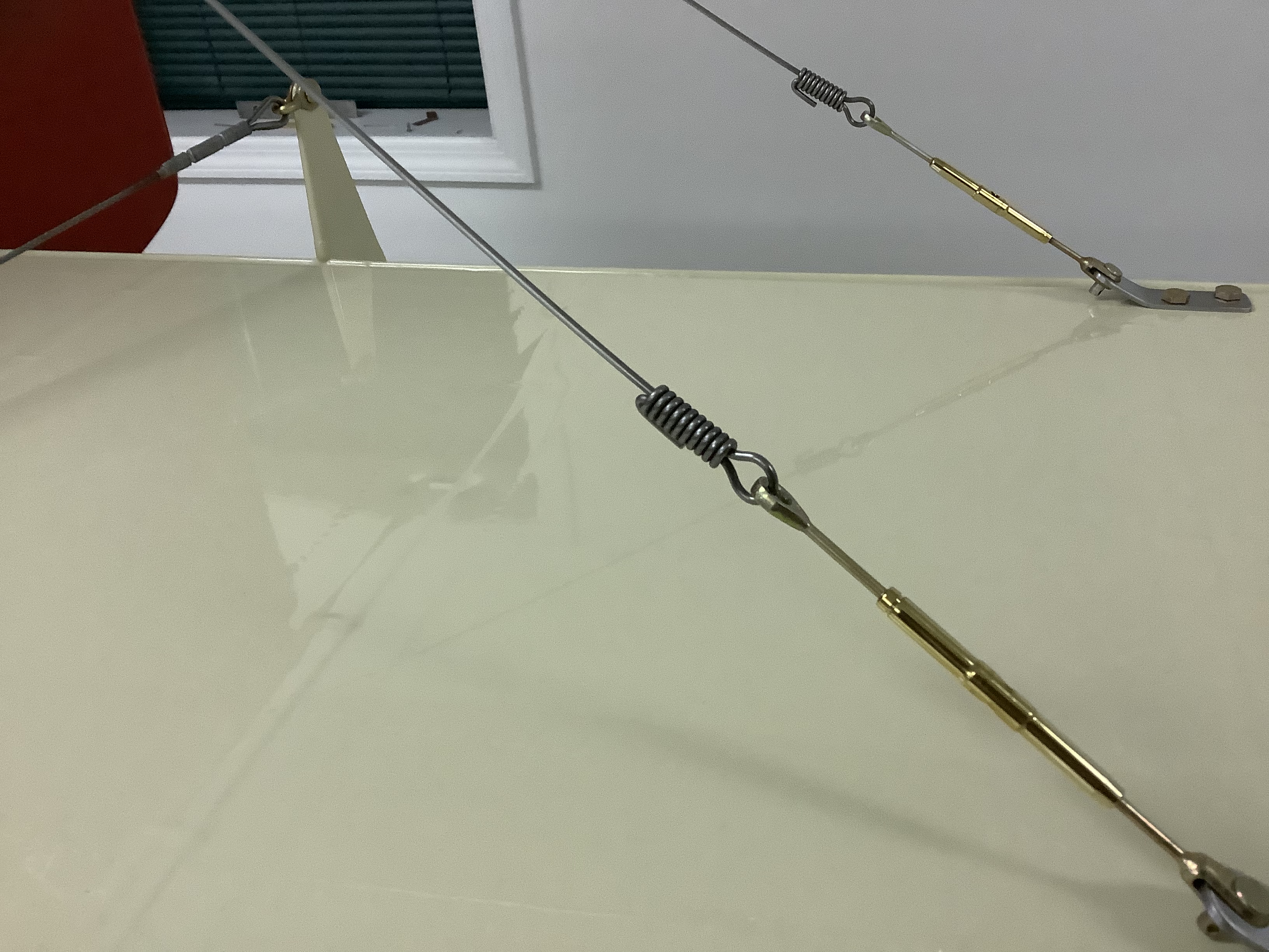

Wow, that is a beauty!!! Museum quality for sure. I zoomed in on the tail to see if maybe you used wire ferrules on the tail braces but it looks like conventional Nicopress with aircraft cable. Yes-? A sparkling rendition of a classic airplane.
Thanks Oscar
Brace wires are hard wires. Also all wrapped and soldered cable ends. Everything period correct as possible.
