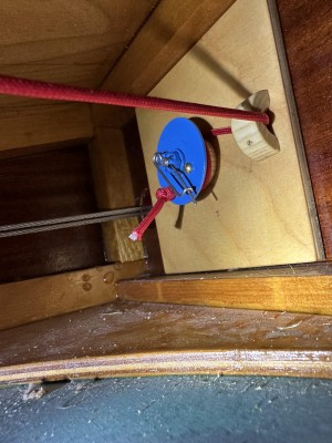

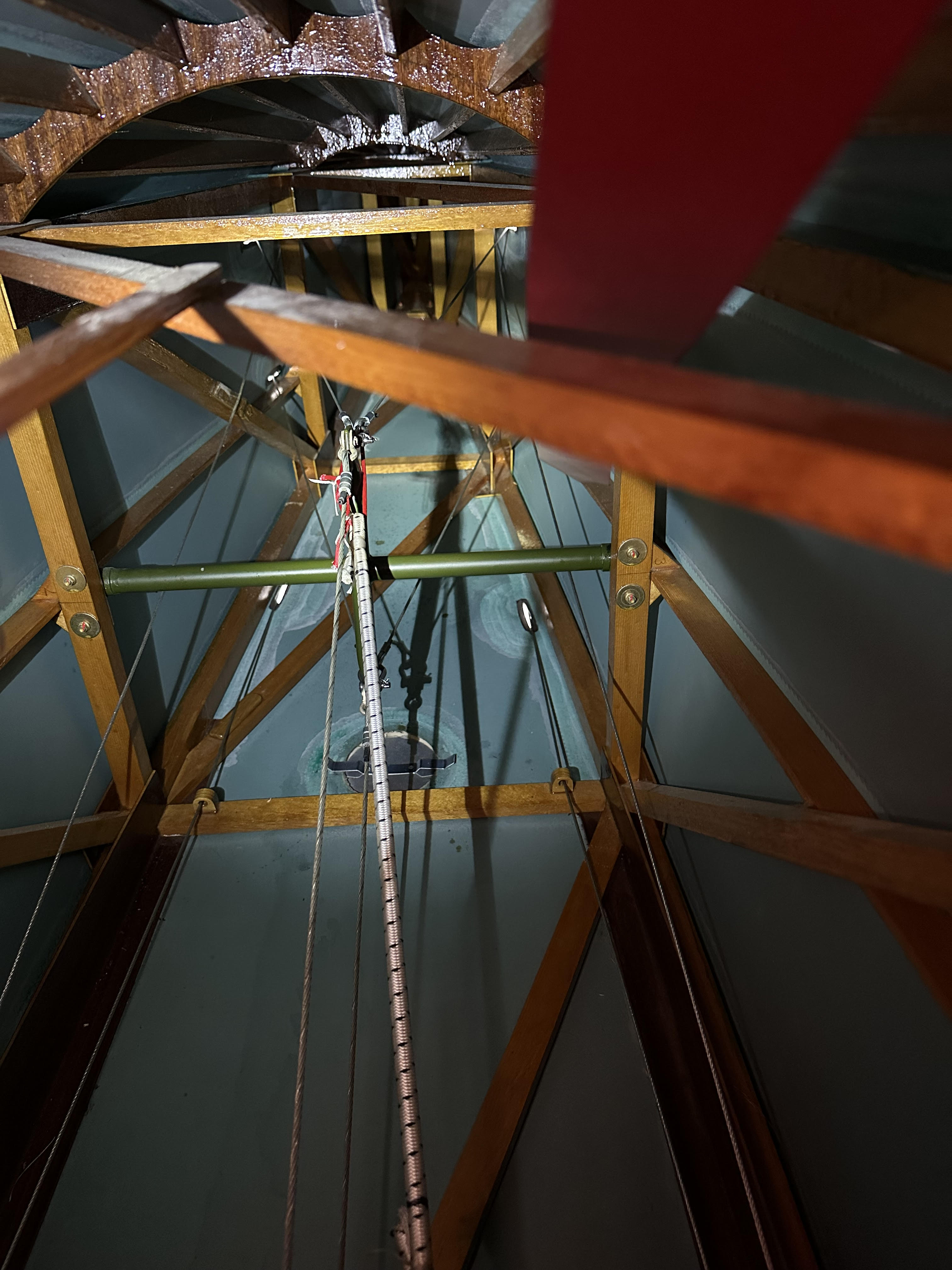

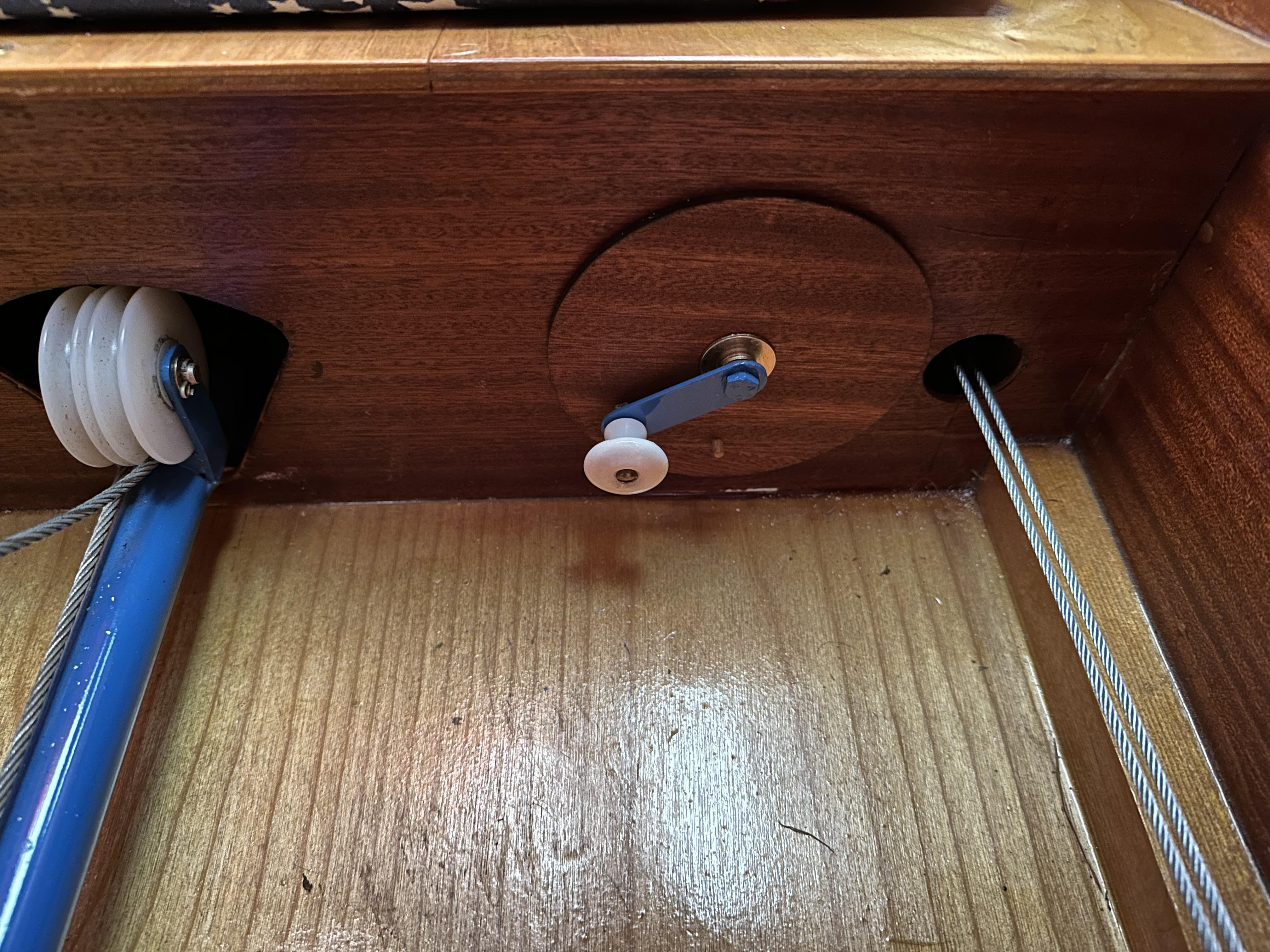

Here's some pictures of the way I did mine. Pretty much the same but instead of a vernier, or a keyhole, it's a crank and a spool.
The whole contraption weighs seven and a quarter ounces. Two and a quarter of which is the 3/8" bungee, and para-cord.
One key to this here set up, which you can't see in any of the photos, is to use a wave washer. That way you can set how much holding pressure you got.
And now that I'm looking at these photos, I guess I need to vacuum from under the seat!

Clever setup, Dan! My only gripe is that it still employs the one thing I've had trouble with... bungees that lose their stretch over time. Or maybe it's the Harbor Freight bungees that I'm using? :o
