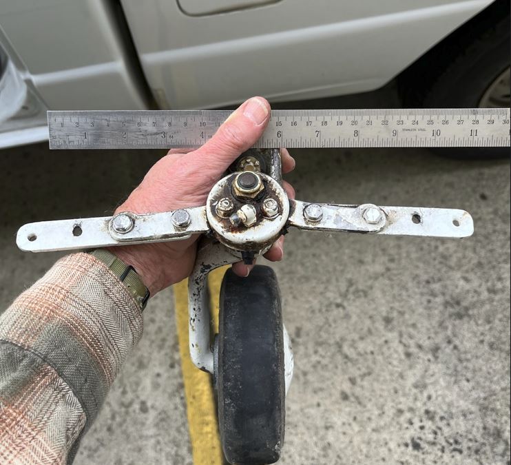

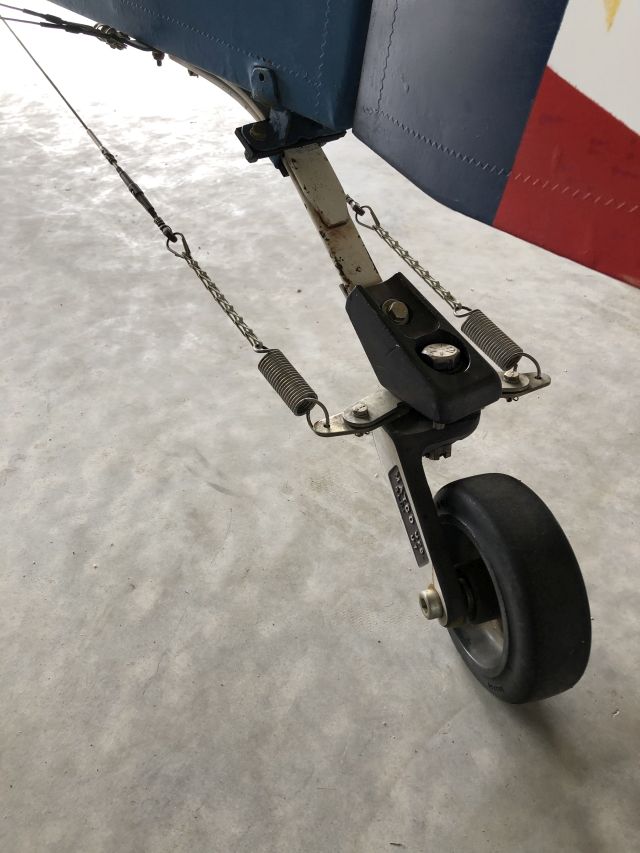

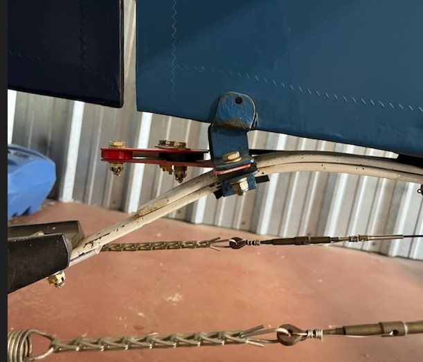

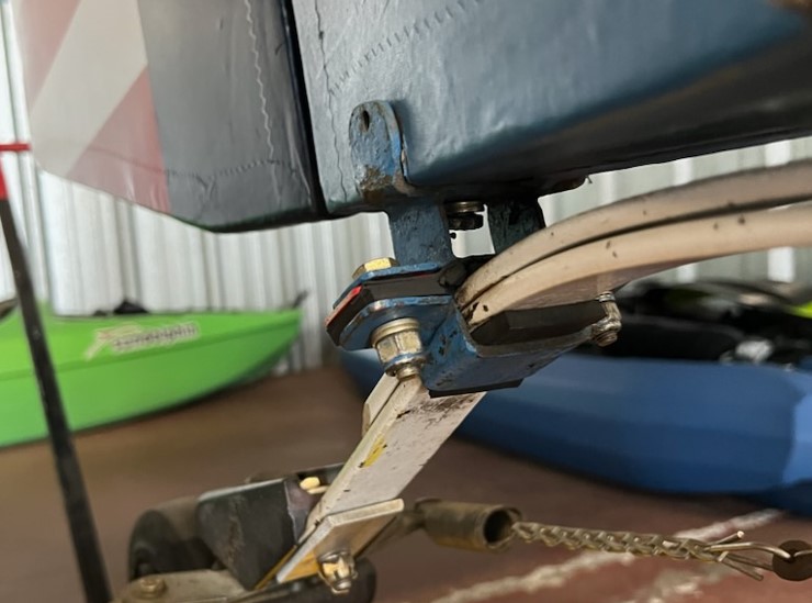

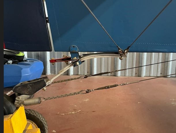

Mark; FWIW, here's my tailwheel setup. Very conventional, as you said, with a Matco tailwheel. This is an older photo... I now also have a tail tiedown release mounted back there, with a cockpit-operable release lever, for when I prop-start my plane unassisted. I patterned mine after the one Richard Roller built for his plane and it works great. Prior to this, I was using a wheel chock with a line on it so I could pull it into the cockpit with me and that was clumsy.
Re: tail wheel steering vs castering
Ken; now you've got my curiousity going about the rudder horn and tailwheel horn having the same control arm lengths. The plans show the holes on the rudder horn to be 10-1/4" apart but I don't know what the tailwheel horn holes are spaced on my plane and will have to check. I do remember when I had the original little Scott 2000 tailwheel on it that Corky used, he had added some short extenders to each of the steering brackets on it so maybe that's why he had done that. I always just thought he did it to make the ground steering less twitchy.
Oscar,
A bit of background. My rudder horns are built to plans with the holes spaced approx. 10" apart, as you indicate in your message. I repurposed a standard Van's RV tailwheel for my Piet. The horns on those have the holes about six inches apart (I don't recall the precise distance, though I'm happy to measure it). As mentioned above, I have one cable running to each side of the rudder that Y's off aft of the pilot seat inside the tailcone. The second cable on each side runs to the tailwheel horn. This means that rudder pedal inputs are the same to both the tailwheel horn and to the rudder horn. The lever arm represented by the horn distances was what I needed to address. One more note. I have rudder pedals, not the rudder bar as called out in the plans. I am happy to chat about that, but I don't think that difference is relevant to the tailwheel/rudder issue.
When I was originally doing taxi testing, At slow taxi speeds, I found that I was having to use what seemed like excessive amounts of rudder pedal inputs even for relatively small turns. That was annoying but not dangerous. At higher taxi speeds, I found that when the rudder began to be effective, I was way overcontrolling the rudder inputs due to the amount of inputs needed to deflect the tailwheel. I added extensions to the tailwheel horns so that the holes would be at precisely the same distance apart as on the rudder horn. I don't know if they needed to be exactly the same. Once I made them that way the problem disappeared. So I largely forgot about it ... until this thread.
I've attached a photo where you can see the extensions.
Ken; those tailwheel control arm extensions that you have are pretty much identical to what Corky added to the Scott tailwheel that used to be on the plane. Now you've got me started on this and I'm going to have to go measure the spacing on the Matco arms that I'm now using, and the Scott arms with extenders that are still lying around the hangar somewhere. Parts for that tailwheel got astronomical so that's why I swapped.
Oscar, as an FYI, I had a conversation about this issue at the time with Douwe Blumberg. He had had a similar experience and had also added extensions to his tailwheel horn. I suspect his are more artfully installed. I've seen his Piet in person several times, but have been so wowed that I didn't notice the tailwheel. Cheers, Ken

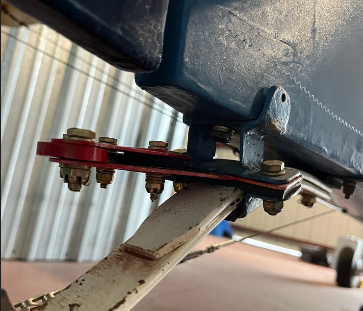

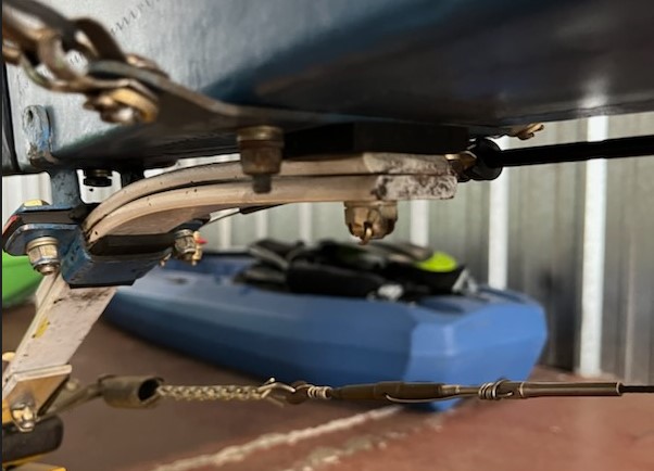

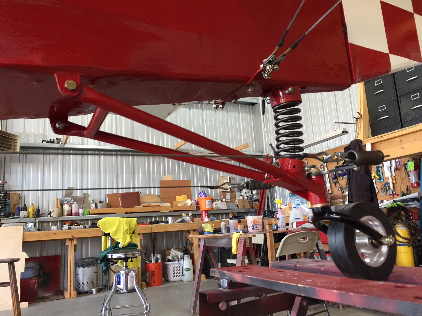

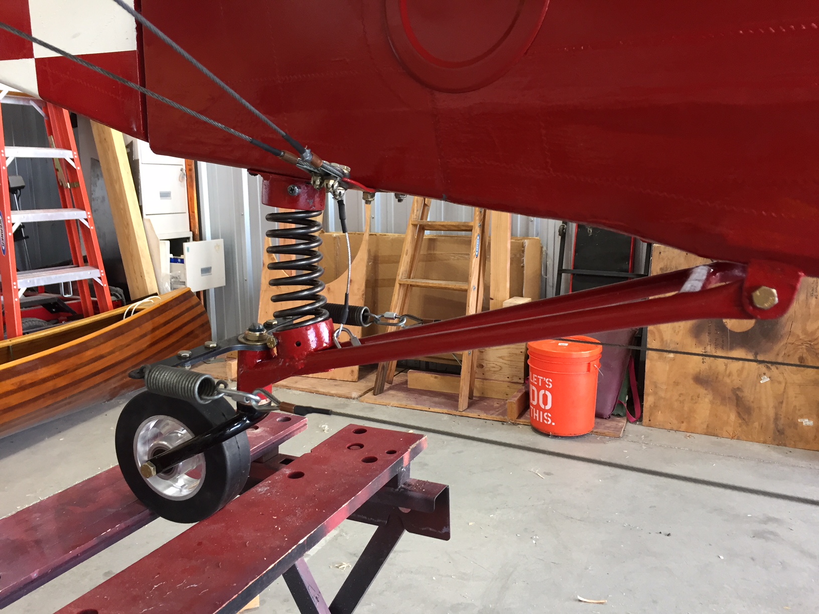

Mark; see photos. First one is a side view of pretty much the whole setup and you can see that the front end of the tailspring shares a mounting point with the bracket where the lower tail brace wires attach on both sides of the underside of the tail. If I understand Ken correctly, that's the weak point of these setups when a side load is put on the tailwheel because then the tailspring creates a lever arm that is essentially prying open the V that the lower longerons form back there. The area can be strengthened, with some study, although I have not had any problems with mine.
The other shots are closeups of the two main mounting points for the spring. The bracket right where the top spring ends is really the key to the whole setup. I have solid rubber shock absorption pads on the top and bottom of the spring where it's clamped into that bracket because that's the way Corky built it. You will notice a red gadget sandwiched into that stack on the starboard side of the tail; that's my tail tiedown release and the bracket bolt on that side just happened to be a convenient spot for me to mount the release and it also provided a pretty much straight shot for the actuation cable to lead forward to the cockpit from the tail. Let me know if you want to see anymore detail, but it's a simple setup. The tailspring is, I believe, just the Aircraft Spruce "homebuilder" dual-leaf spring.
By the way, there's a mix of hardware back there but everytime I work on something back there I replace nylock nuts with cotter pinned castellated nuts that I can readily inspect because back when I was flying with the Scott tailwheel I noticed a funny feel to the tail as I was taxiing one day and upon inspection I found that the nylock nut on the underside of the big bolt that mounts the tailwheel to the end of the spring had backed itself off enough to where the end of the bolt was already a few threads up into the nut. I had grown accustomed to just glancing back there on preflight and seeing a nut there, thinking all was well and moving on to other things. Not anymore.
One more shot; this one looking into the spring bracket from behind. It is made up of several pieces and you can see that the two 'ears' that are bent up were going to be through-bolted but I guess Corky felt that the vertical bolt from underneath was plenty since there have never been fasteners in those holes. He also didn't exactly match the angle of those ears to the tapering profile of the lower longerons at the tail, but it doesn't really matter much.

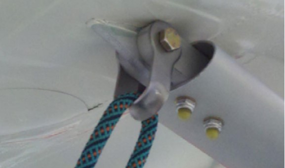

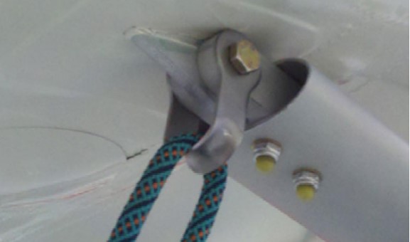

Oscar. Are those homemade shackles on the brace wires to strap attach?
Richard, I'm not sure what those are or where the builder got them from, but they're used in several places throughout the airplane. They are stainless steel. I've never had an inspector mention anything about them and I assume that the builder's FAA designee didn't either, but I have replaced them with conventional AN115 type shackles whenever I've worked on things and had a chance to replace them.
Looking through the Aircraft Spruce catalog, the shackles you're looking at on my airplane appear to be similar to the RANS tiedown shackles but smaller. See photo of the RANS shackles.

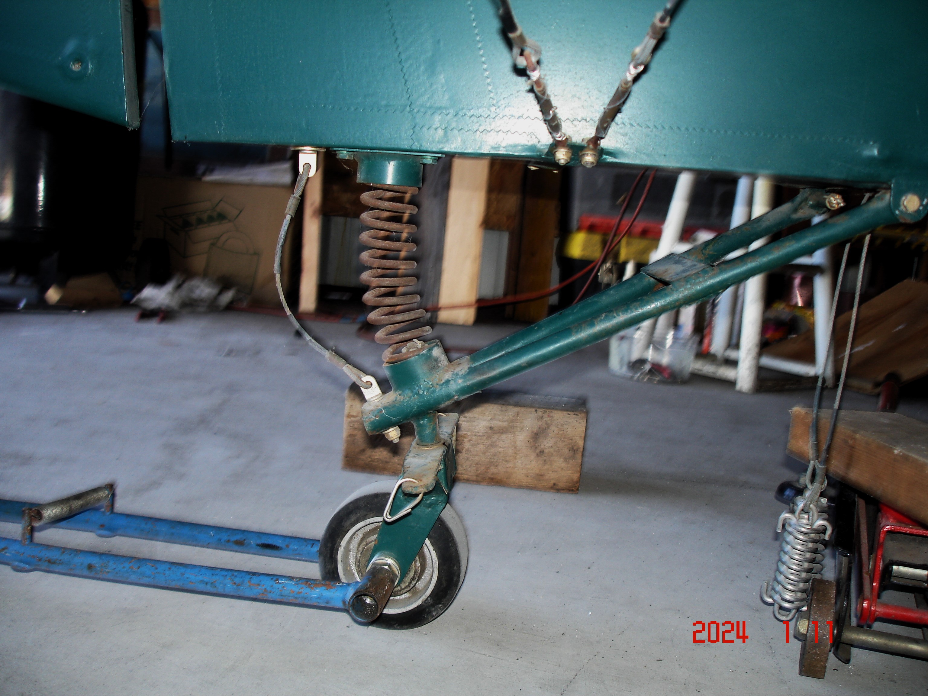

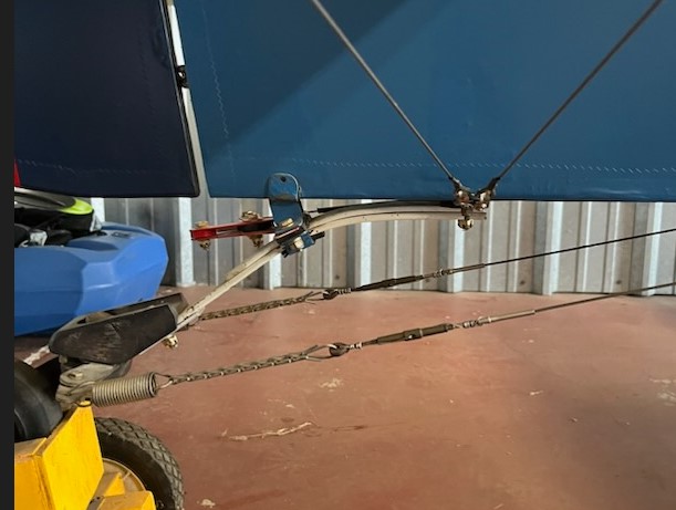

New to the Pietenpol. Ours has the “A” frame with coil spring and welded on kingpin section, and a “shopping cart” wheel.
I would have no problem with any of that except - unloaded the kingpin angle is about 15 degrees forward. I do know that either dead-vertical or a few degrees forward is good, but this extreme angle makes even pushing the airplane around difficult.
I can see maybe carefully bending the A frame to get a more reasonable caster angle - but at this point I am wide open to suggestions.
We now use the API tailwheel exclusively on the Cubs, but they are difficult to buy at the moment. I would convert in a heartbeat if I could buy more. The old Maules, Scotts, and Langs all languish in a box labeled “obsolete tailwheels.”
Should I expect that undamped coil spring to give me oscillations in a three point landing?
Bob,
The A frame design has been around a very long time. I'm not a fan of non-steerable grocery cart-style tailwheels, but I understand that they have been used on Piets in the past. I welded a Van's RV type steerable tailwheel assembly to my A frame.
My suggestion is to measure the rake angle with someone in the pilot seat whose weight is approximately your's. It might be that you need to shift to a softer spring (or perhaps even a stiffer one).
With the A frame on my Piet, I find the feel on three point landings to be just about right, with no tendency to bounce me back into the air. In fact, my best landings are when I touch down tailwheel first, followed shortly thereafter by the mains.
Maybe attach a picture. That would help us see what you have.

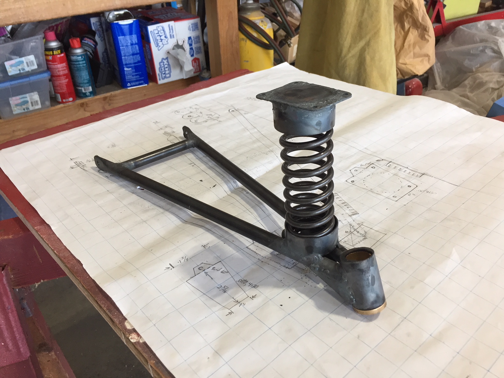

Pretty sure I can attach a photo. The tailwheel kingpin had a 20 degree(!) positive camber angle, unloaded. As you know, that does not change much when the A frame moves up and down, since the kingpin angle change is the same as the very small angle change of the A frame itself.
Photo is of the original. With a giant tubing bender, I changed that to a five degree positive angle, which is more in line with what we like to see on Cubs.

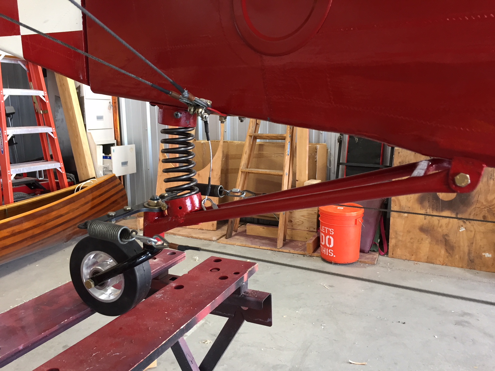

Bob, I see what you mean about the rake angle. That's pretty severe. I've attached a couple photos of mine. You'll see that when the plane is leveled up (with the top longeron as the datum), the rake angle is actually negative. When it's in the three-point attitude on the ground, the rake angle is just a few degrees positive. I've been very pleased with how it tracks. Cheers, Ken

Thanks. Yours looks like a better design. I will most likely be installing a real aircraft tailwheel, to gain full swivel capability. But for now, I have a good angle, and a way to get the towbar on there for rearward positioning.
