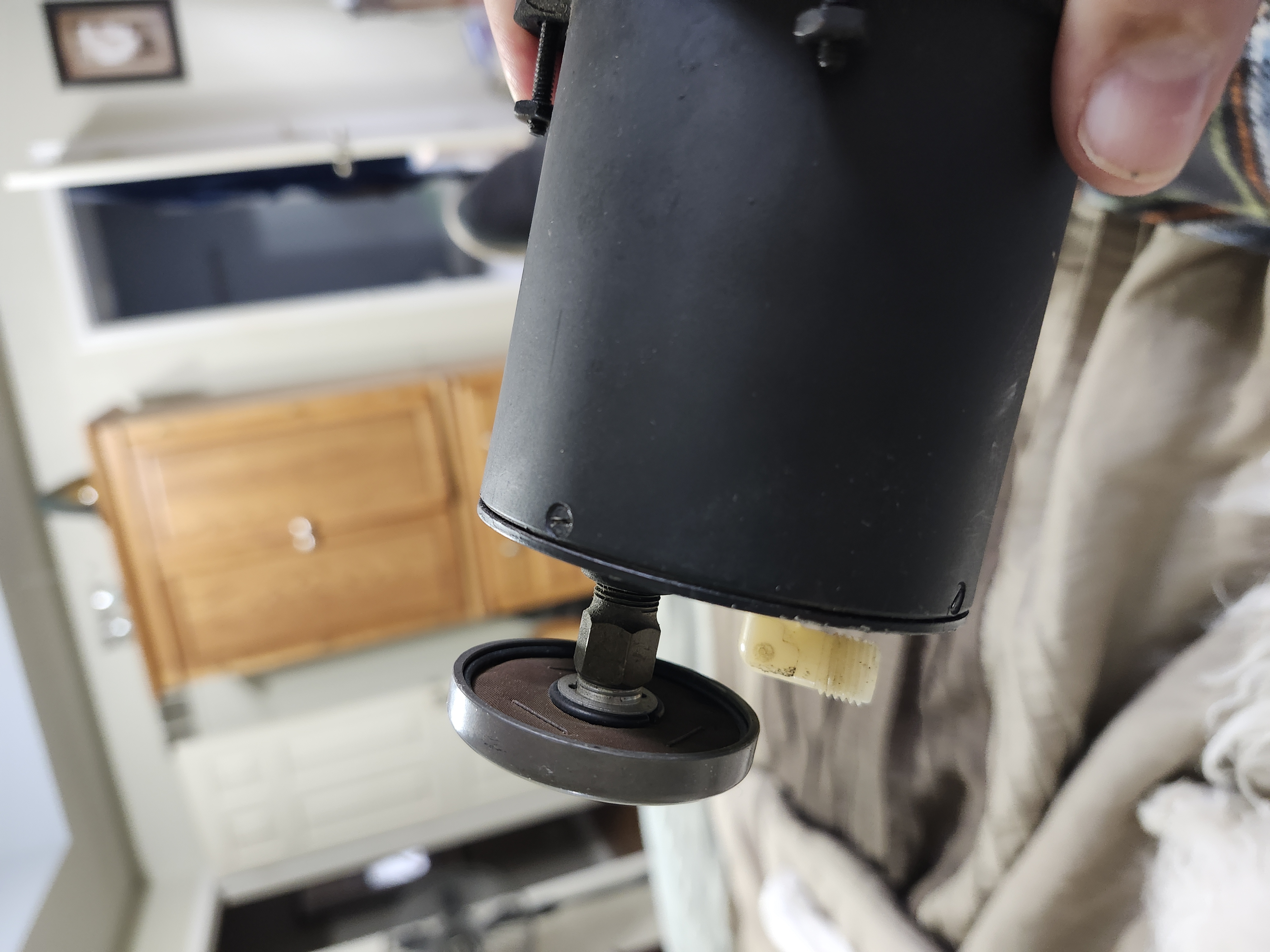

My Piet was built without static ports originally. It has "static buttons" on the airspeed indicator and the altimeter. It works.
Never the less, I don't like it that way. It can be erratic at times. The pilots instrument installation in the Piet tends to trap air (pressure) which messes with the indications. Slips one way (on my a/c) will drop the airspeed right off the bottom of the gauge. Probably minor issues if you are familiar with the a/c. Ken Perkins, the original builder, told me a couple of times he wished he had done it differently when he built.
Since I'm rebuilding from my crash, I intend to have a static port(s) when I get to that point. At the moment I'm leaning toward the combination pitot/static used on Dan Helspurs Pietenpol.
I've attached pictures of the button on my airspeed indicator.
A link to the style pitot/static Dan has: https://www.aircraftspruce.com/catalog/ ... t15144.php

where do you get those 'static buttons"?

I have no idea where he came up with the static buttons.
