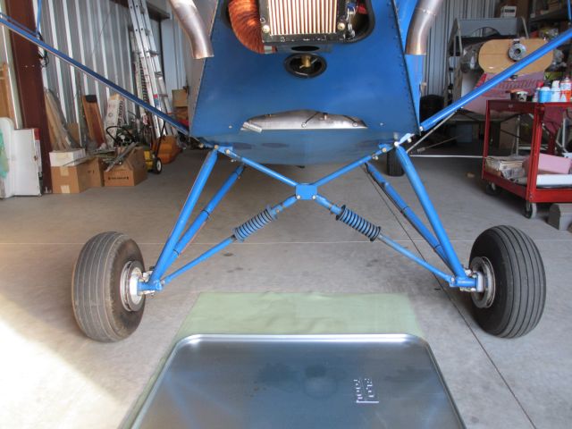

Boy, now I'll have to go look at my plane because I think mine has a 'razor ridge' running down the belly, similar to the ones on the sides to hold the fabric away from the wood and turn flat panels into slightly prism-shaped ones. Stand by...
Posts: 709
Re: Is exterior of floor covered or painted
My airplane does have vertical strip of wood running down the underside from firewall aft, which means that the belly fabric does not touch the plywood except at the longerons. Perhaps the slight 'v' shape along the belly can be seen in this pic:

So, does that mean I have to run a board down the center of the belly? Or can the fabric just run across from the bottom longerons (I don't need the board)?

It means it is up to you. I doubt the originals had a stringer down the center of the belly. And I'd say a fair percentage would have been covered the entire length. Just know that adhering the fabric to the plywood belly will pickup any undulations in the wood. And close quarters between the wood and fabric makes for problems down the road if any moisture is introduced. Having a stringer running down the center gives some space for air to flow and keep things dry, and creates opportunities for adequate drainage when there is enough moisture to create flow.
And whatever you choose to do, check your glue and covering systems for compatibility with your varnish.

34KP does not have a stringer running down the bottom. Flat plywood, fabric covered.
