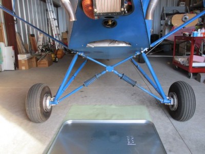

Boy, now I'll have to go look at my plane because I think mine has a 'razor ridge' running down the belly, similar to the ones on the sides to hold the fabric away from the wood and turn flat panels into slightly prism-shaped ones. Stand by...
Re: Is exterior of floor covered or painted
My airplane does have vertical strip of wood running down the underside from firewall aft, which means that the belly fabric does not touch the plywood except at the longerons. Perhaps the slight 'v' shape along the belly can be seen in this pic:
