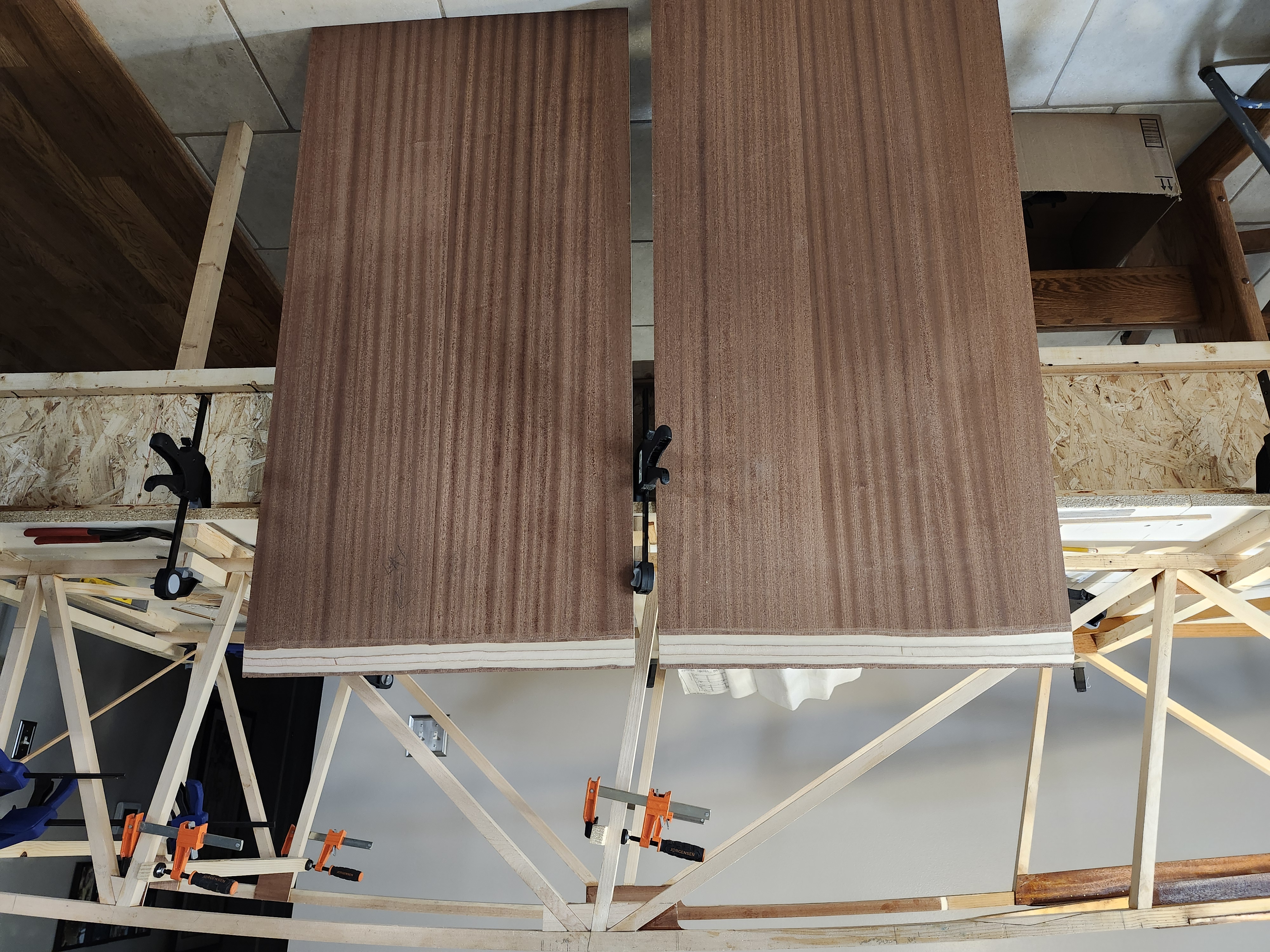

I have to scarph 2 pieces together for the floor board. Here goes nothing!

Re: N34KP's rebuild
The second one (left) turned out nicer than the first. I'll clean up the first one and glue tomorrow.

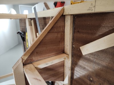

I decided to block the corners of the firewall station truss.

Re: N34KP's rebuild
I'll bet that fuselage frame is stiffening up nicely, what with the blocking and crosspieces and gussets getting installed. One of the most comforting things about a Piet is the robustness of its basic structural 'cage'.
Posts: 368
Re: N34KP's rebuild
Yes. It's getting pretty sturdy even without the side plywood.
